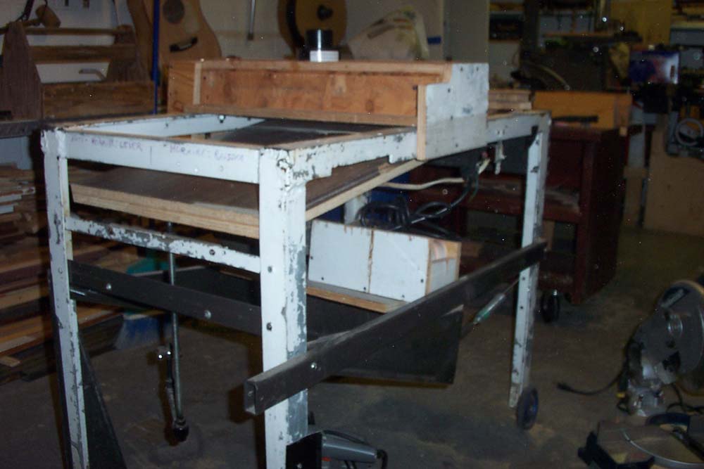

Hi Russell and Bob, i saw a few sets of wood that nailed my chin to the cement floor of my shop. i think i'm gonna go with the blanket and bulbs, kinda like the cheapo bender too, you never know, just in case,Thanks JOHNO and Dave!
Russell, i will follow your advice with practice wood and Bob, i'll follow your advice too.BTW Bob, i followed your example already by making a drum sander a bit similar to yours,here's a piccy.
Serge Poirier38723.3625231481
